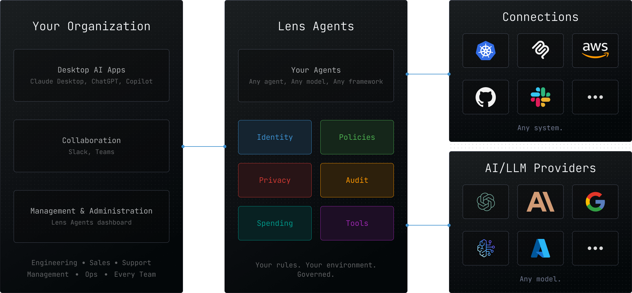

How Lens Agents works#
Lens Agents is a control plane you install into your own Kubernetes cluster, plus a sandbox runtime it schedules onto that cluster. Nothing about an agent's work leaves your infrastructure unless a policy you wrote says it may.
Architecture#
graph TB
subgraph cluster [Your Kubernetes cluster]
subgraph platform [Platform server]
api[REST API · MCP · Admin UI]
policy[Policy engine]
audit[Audit writer]
llm[LLM proxy]
end
db[(PostgreSQL)]
subgraph ns [Sandbox namespace]
sb[Sandbox pod<br><i>supervisor · agent · egress proxy</i>]
end
api --- db
api --> sb
end
clients[MCP clients · nexusctl · CI] --> api
sb -->|governed egress| upstream[Your systems<br><i>Kubernetes · AWS · APIs · MCP servers</i>]
llm --> models[Model providers<br><i>Bedrock · Foundry</i>]

Where agents can run#
The governance contract is the same in all three cases. What differs is where the agent's process lives.
| Runs in a sandbox | Connects over MCP | Managed agent | |
| Agent process | In your cluster | Wherever it already runs | In your cluster |
| You supply | An image | An MCP client | Configuration |
| Typical | Autonomous agents, batch jobs, long-running workers | Claude Code, Cursor, Claude Desktop, custom agents, CI | Lens Prism |
| Start at | Sandboxes | MCP endpoint | Managed agents |
An agent connecting over MCP does not run unguarded: it gets a sandboxed toolbox in your cluster, and its work happens there under the same policy and audit as everything else.
Defense in depth#
No single control is load-bearing.
| Layer | Control |
| Identity | Every actor — user, API token, sandbox — is a distinct principal with its own bindings. |
| Authorization | Org, team, and project RBAC decide what a principal can see and change. |
| Policy | Default-deny network, per-domain method and path rules, tool allowlists, managed-inference opt-in. |
| Isolation | Unprivileged process, nftables lockdown, proxy-mediated egress, optional per-sandbox microVM. |
| Credentials | Injected at the boundary, never present in the sandbox. |
| Spend | Per-org, per-user, per-agent, and per-sandbox budget caps. |
| Audit | Every API call, tool call, command, and proxy decision recorded — allowed and denied alike. |
An agent that is compromised, jailbroken, or wrong is contained by the layers underneath it, none of which it can talk its way past.
