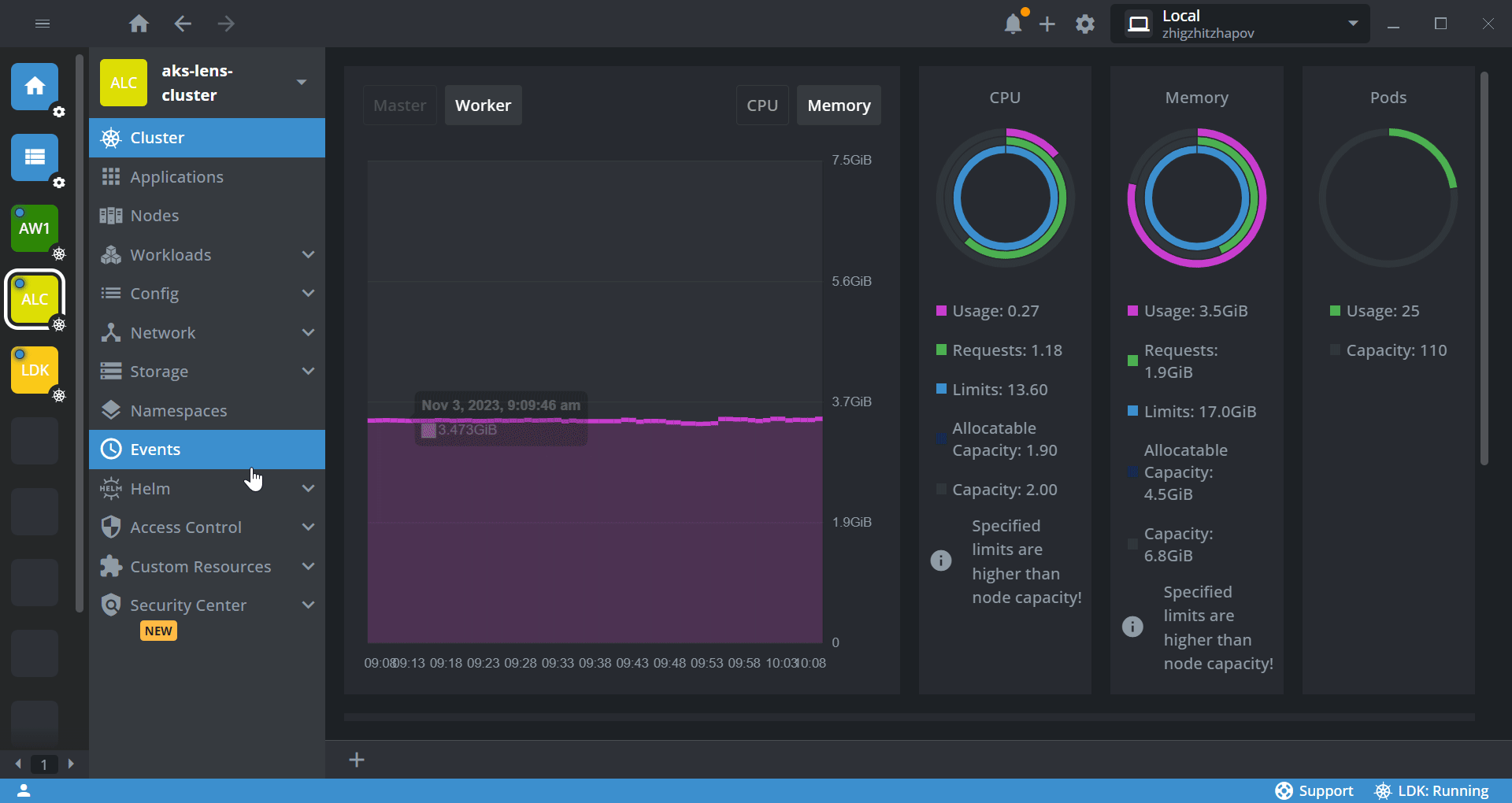

  1. From your cluster, navigate to Helm > Charts.
  2. Find and select the necessary chart in the Charts table.

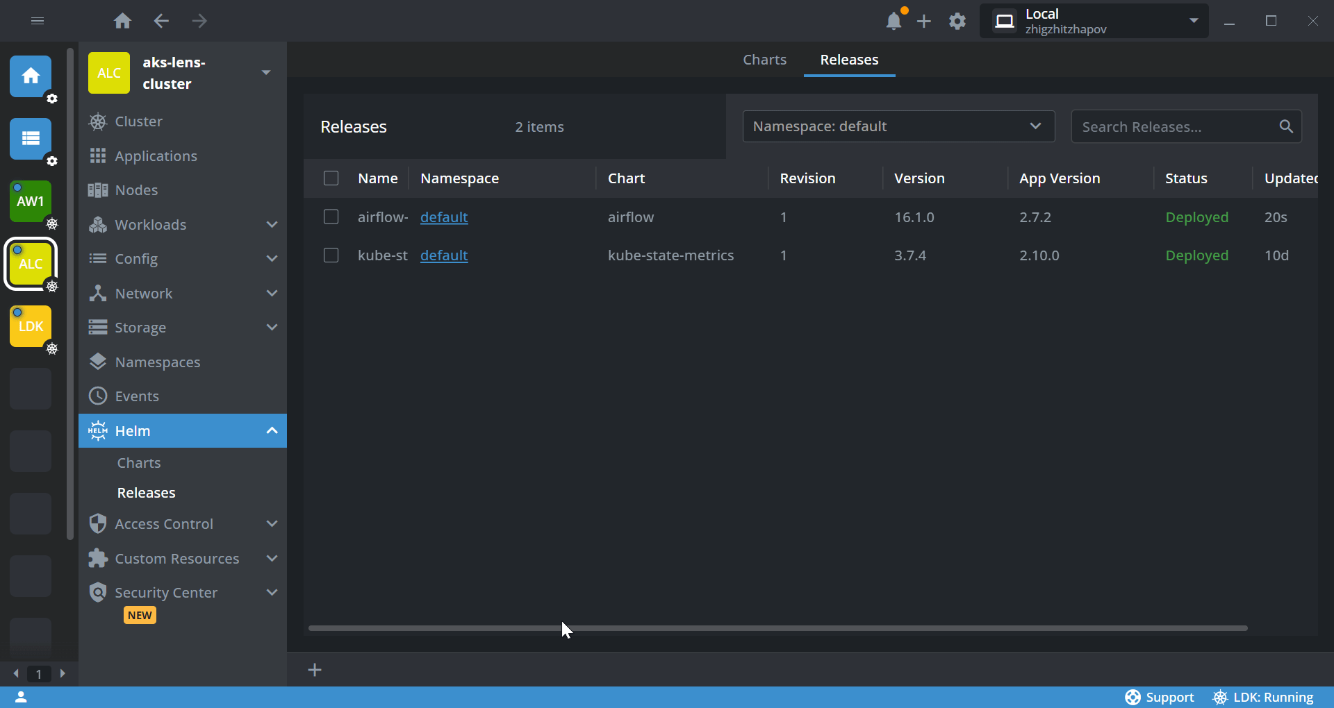

  1. From your cluster, navigate to Helm > Releases.
  2. Select the chart.
  3. In the details panel, click Upgrade.
  4. On the Helm Upgrade tab, click Upgrade & Close.
To remove a helm chart:
  1. In the Releases table, click Options > Delete.
  2. In the following dialog, click Delete.
