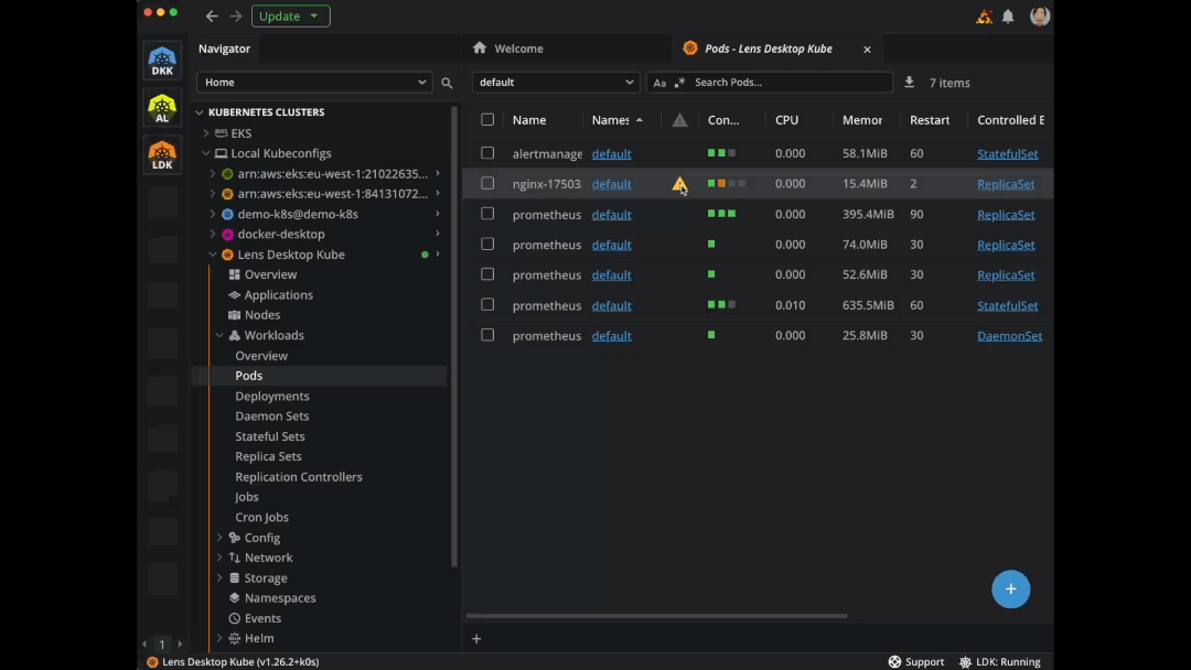

See the illustration of Lens Prism below:
An GIF illustrating Lens Prism
