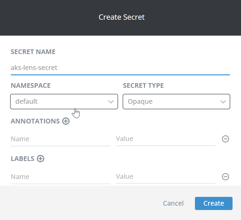

Use a dialog menu#
For example, to create a secret through a dialog menu:
  1. Navigate to a resource page and click Create new Secret add in the lower-left corner of the page.
  2. In the following dialog menu, configure necessary parameters and click Create.
    the Create Secret dialog menu
You can create the following cluster objects by using dialog menus:
