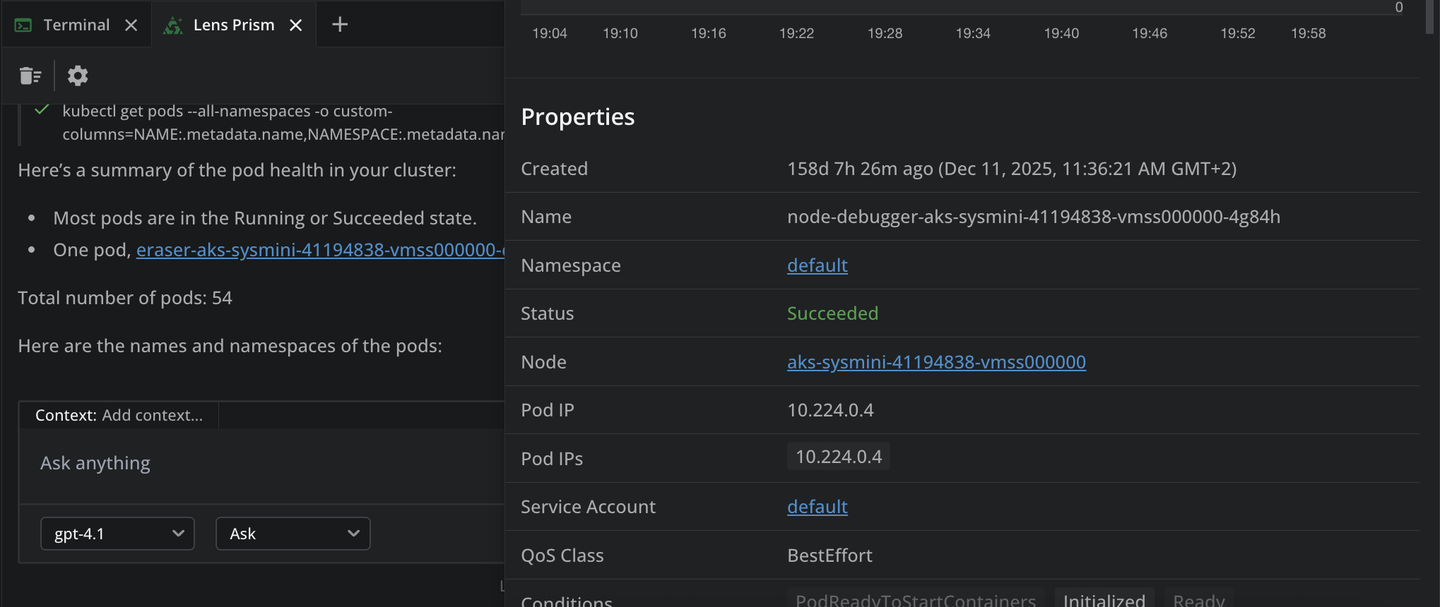

Open resources from a response#
When Lens Prism mentions a Kubernetes resource in its answer, the resource name appears as a link. Click the link to open the resource's details panel next to the chat without leaving the conversation. Use this to inspect metrics, events, logs, or configuration for any resource Lens Prism surfaces during an investigation.
Clicking a resource link in a Lens Prism response opens the resource details panel
